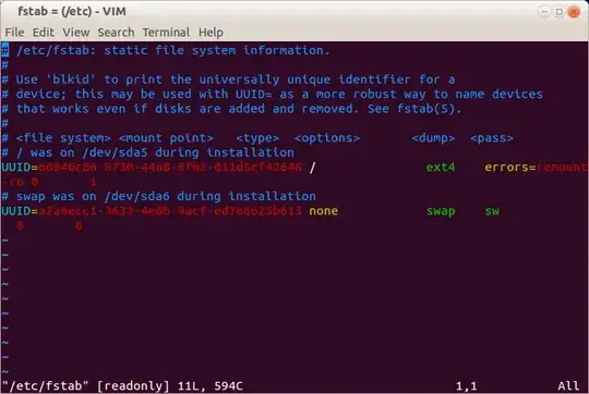

These are my all partitions.
This is my /etc/fstab
I would like to auto mount sda3 (NTFS), sda6 (ext4), sda7 (ext4) on startup, please help me edit the /etc/fstab file.

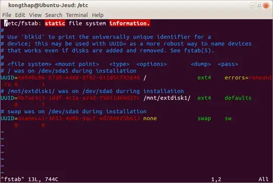

Edited!!!
I've edited fstab as shown in the picture, I got error during booting, please help me find out what went wrong. P.S. I've created /mnt/extdisk1, I copied and pasted the UUID so it was not misspelling.
