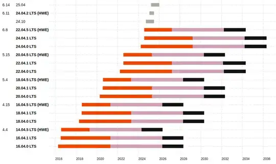

List of Ubuntu Versions with Corresponding Linux Kernel Version pointed me to https://ubuntu.com/about/release-cycle which has a table that makes it easier to understand how things work:
By looking at that table, we see in more details what other answers mentioned. For example:
  • 24.04.0 and 24.04.1 had kernel 6.8
  • 24.04.2 moved up to kernel 6.11, the same one used in 24.10, to support newer hardware. So here the 6.11 is then considered the HWE kernel for 24.04.
