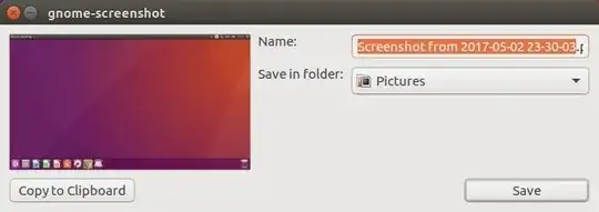

I want to change this behaviour so that immediately upon pressing Shift+PrntScr the screen capture application allows me to select an area, and immediately afterwards it provides me with the option to save to a particular location or clipboard.
I want Shift+PrntScr to bring up a pop-up screen like this:

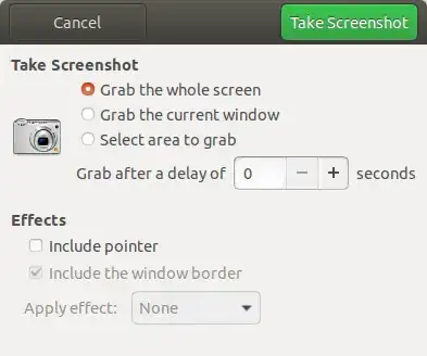

Try this answer first to get something identical to the old behaviour.
You may create a new keyboard shortcut for the command
gnome-screenshot --interactive
as an alternative.
To do that follow the steps.
  1. Open Settings > Devices > Keyboard and scroll down to the bottom.
  2. Click on the + symbol. A dialogue should pop up.
  3. Enter any name you like in the Name box.
  4. Enter gnome-screenshot --interactive in the Command box.
  5. Click on the Set Shortcut... button and set any keyboard combination which doesn't cause any conflict, for example Super+Print.
  6. Log out and log in again.

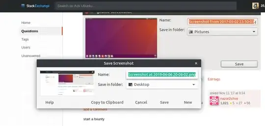

Now whenever you press Super+Print a window offering various screenshot options (whole screen/current window/selected area) should appear. Once you take the screenshot it will offer you to choose the location to save the screenshot as in the image in your question.

The previous behaviour of gnome-screenshot (as illustrated in the question) was press PrtScrn, possibly with modifier keys, to take the shot and then the save-as dialogue would come up.
No solution suggested for gnome-screenshot-3.25.0 replicates exactly that. The only way I managed was to install gnome-screenshot_3.10.1 and use apt hold to stick it there.

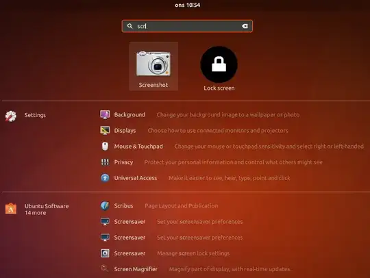

There is no popup [from the hotkey combos] now, but the screenshot tool is still there in Ubuntu 17.10.
You can find it via Activities (in the top left corner) if you type a letter or a few letters, s, sc, scr ...
Click on the camera icon, and you get the screenshot app window.

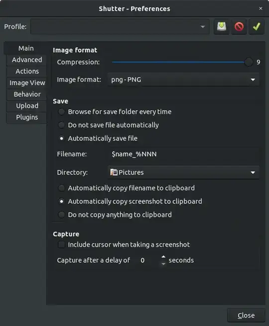

Take a look at Shutter, it do very well. Screen, window, or area of screen screenshots with various options. Sit in tray and waiting for click or keyboard shortcut. You can rename file or configure auto naming. Here are screenshot of main options window. enter image description here
