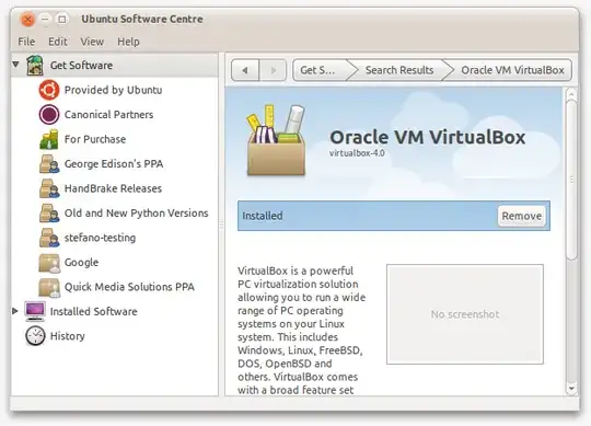

Manually installed packages appear in the Software Centre, along with all the others. Just search the software centre for your package and remove it there.
You may have to click on "Show N technical items"
alt text

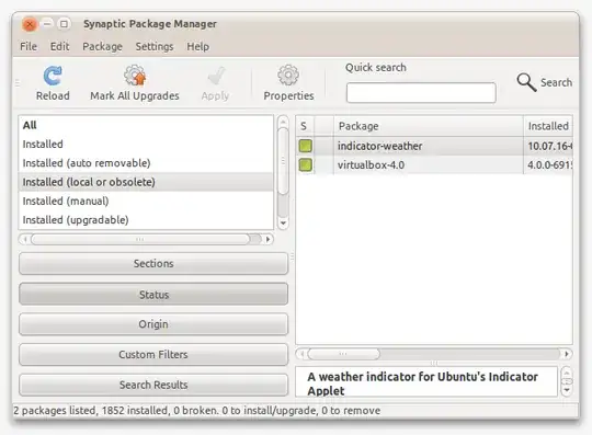

Synaptic:
  • Go to System → Administration → Synaptic Package Manager
  • Click the Status button and select "Installed (local or obsolete)"
  • Right click a package and select "mark for removal".
  • Click the Apply button.
    This will have the benefit of listing all of your manually installed packages:
alt text

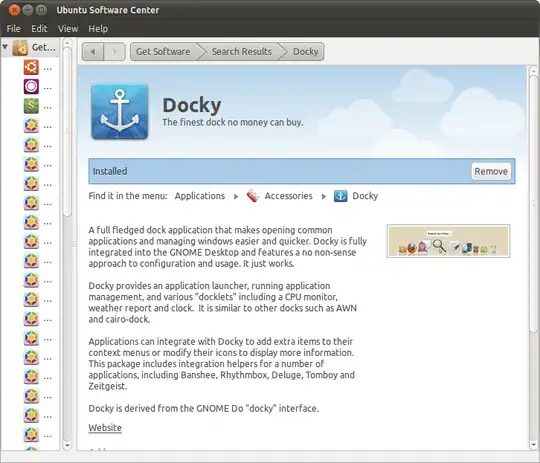

Open up Ubuntu Software Center (Applications -> Ubuntu Software Center) and search for the package you want to uninstall, and click on the Remove button:
alt text
