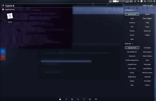

The most likely reason for this is that you have accidentally deselected applications on the filters setting for unity dash Try setting your filters as shown in the image below and searching again for typora:
filters
Edit: If the root cause of your issue is a packaging problem as indicated by this comment removing your existing package and installing the current one should resolve your issue.
