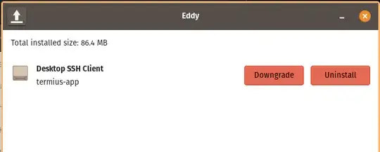

TL;DR: Double click downloaded .deb file & click Uninstall from graphical package manager
Following the above link, you are presented with a blue "Download" button. Clicking that button prompted me to save opera-stable_86.0.4363.50_amd64.deb. You most likely saved this file in your "Downloads" folder. Double clicking the downloaded file opera-stable_86.0.4363.50_amd64.deb should open the graphical package manager Eddy. From there, you should have the option to uninstall Opera.
Eddy Package Manager showing option to uninstall or downgrade terminus-app
-3
