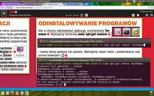

Możesz You can enter the shop on ubuntu installed applications. There easily uninstall Mozilla. Or see my screena.Jest written in Polish but you should know what's going on.
