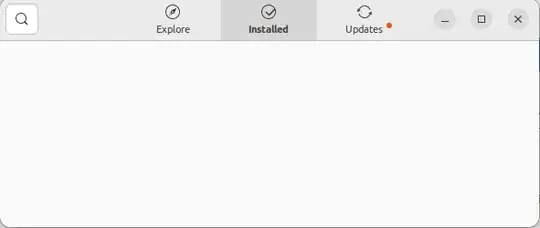

I downloaded and installed an older version of STM32CubeIde from this site a while ago. It is a dot DEB file version 1.5. How do I completely remove this software? Ubuntu 20.04 is the OS used. Ubuntu Software doesn't show the installed software. Actually, my Ubuntu Software doesn't show any installed software. Thank you very much for your help.
