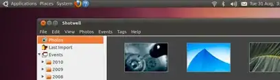

I am running Ubuntu in VirtualBox (on a Windows 7 host). Several times now, the top-level menu bar, the task bar — and seemingly every system dialog — have forgotten the out-of-the-box "Ambiance" theme they conform to when I first installed the system. Window captions still preserve the theme, but pretty much nothing else does.
I have searched high and low on Google for assistance with this problem. Everything I've found suggests either running some gconf reset or deleting .gconf* .gnome* and other similar directories. I have followed all this advice and nothing works. I still get a boring Windows-95-style gray 3D look and feel. On previous occasions, after much messing around I've given up and rebooted the VM instance, and been pleasantly suprised to see the original "Ambience" theme restored throughout the UI, but invariably it disappears again some time later, usually after a reboot, so I can never figure out what I did that broke it.
Here's a sample from Ubuntu's site of what I want it to look like.
alt text
And here's a screenshot of my system as it currently looks.
alt text
Also note that my GNOME Terminals normally have a nice purple semi-translucent look, and as can be seen from the screenshot, they are now just a solid matte white.
This last time (just yesterday), trying numerous combinations all the usual tricks and rebooting several times hasn't fixed it, so here I am on SU wondering:
How do I recover the out-of-the-box theme for my Gnome/Ubuntu desktop, noting that blowing away all config files — as suggested in many places online — fails to achieve this?
