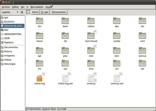

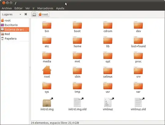

I'm running Ubuntu 11.04 on Virtualbox and I cant' change the nautilus icons. I've followed a lot of tutorials... but nothing works. I can only see the icons I've choosen when I run gksudo nautilus but not when I'm a normal user any suggestions?
This is what it looks like when I'm a normal use:
This is how it should look like:

Like htorque says it's duplicated. I've fix the icons problem with this answer: Desktop forgets theme?
Create a text file. Write in it
include "/usr/share/themes/Ambiance/gtk-2.0/gtkrc"
gtk-icon-theme-name = "ubuntu-mono-dark"
and save it in your home folder under the name .gtkrc-2.0 then restart.
If there are still elements wrong (for me it was the font), you need to add this change to the file, google for a gtk tutorial for the possible fine tunings.
