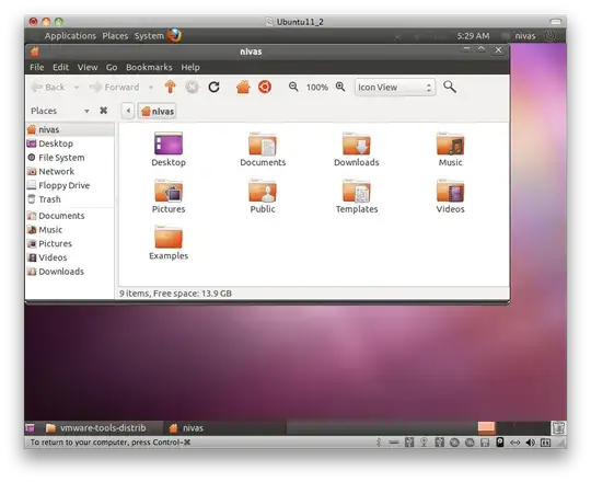

Immediately after I log in:
Immediately after log in

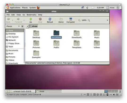

And in "sometime" (~20 to 30 sec):
(I did have the time to open the home folder, but I had to do it quickly)
In Sometime

Your second image is the normal "Classic" mode. Apparently your gnome-settings-daemon dies after 20 to 30 seconds, so you are left with the ugly default theme. You can hit Alt+F2 and enter gnome-settings-daemon to start it again. And/or look in the .xsession-errors file in your home directory to find why gnome-settings-daemon crashes.
