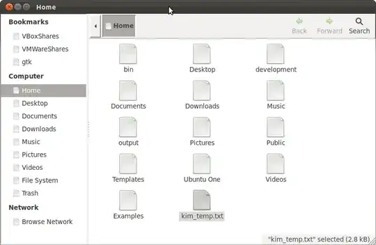

I am using Ubuntu 11.10.
At some point through the day today the GUI seemed to downgrade itself. In some applications the text became grainy, and some icon titles on the desktop became difficult to read.
The upside is that performance really improved. I can now switch between my applications much faster than I could previously.
What might cause this? I'd like to be able to repeat it!
UPDATES:
  • I was not aware of changing anything. I certainly didn't install anything new on the PC, and I was not aware of any automatic upgrades
  • My System Settings says the graphics driver is Unknown and the experience is Standard
  • I'm about to reboot the PC and see if the condition persists!
  • I hope its not magic. That would make it difficult to reproduce, wouldn't it?
  • Just noticed the shutdown menu (top right) is missing. Had to start a terminal session to shutdown
  • screenshot
Screenshot

  1. Check if you recently switched from a proprietary graphics driver which supports 3D to a fall back 2D mode.
  2. Check the state of your graphics card driver which might have been knocked out by a kernel upgrade
  3. Try using Unity 2D to get a faster desktop if you don't mind reduced desktop effects.
