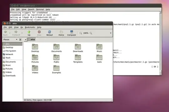

I just installed Ubuntu 10.10, and after activating the Nvidia drivers, and Ubuntu seems to have lost the theme, it looks like old school 9.04 or something (but some parts, like the window title/menu bars look new)
Jorge suggested in the comments that: "This isn't a theme issue, you're gnome-system-daemon is likely crashing. Is this persistent across reboots?"
Looking back, I think the problems started when I tried to start using dual monitors. I ran the "NVDIA X Server Settings" applet, and accidentally chose "Separate X screen (requires X restart)" at which point I got different displays on each monitor, but each had their own panel and applications menu etc. I've since switched to "TwinView" which is the one I think I should have chosen originally.
