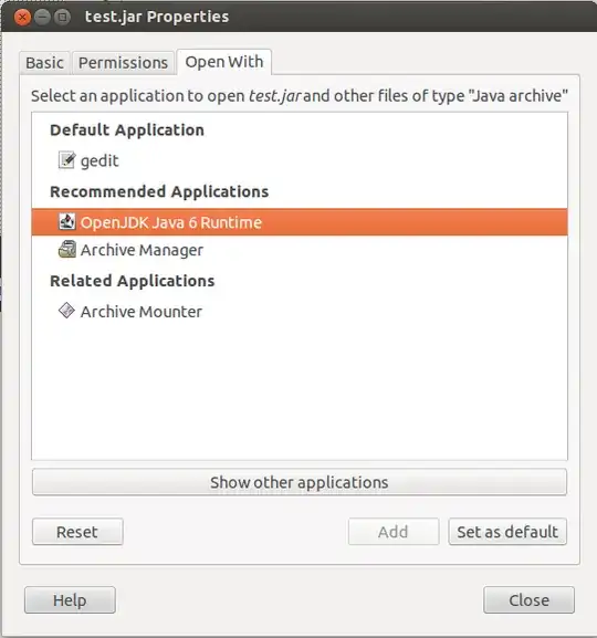

To make Java open .jar files per default (i.e. double click) right click on any .jar file to select Properties. In the following window select the "Open With" tab to see e.g. the follwing choice:
Select your Java runtime and press Set as default to make this your default application to open .jar files.
