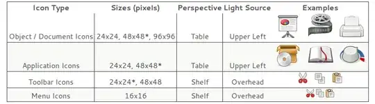

Looking around I found that Gnome has a specification for the sizes:
I'd add to this that this is specifically for Gnome icons (mostly in SVG) and maybe the Tango and Tango-based icons though the table looks quite dated as Gnome includes icons larger than that nowadays and doesn't mention symbolic icons.
So depending on the artist these may be very well vary.
