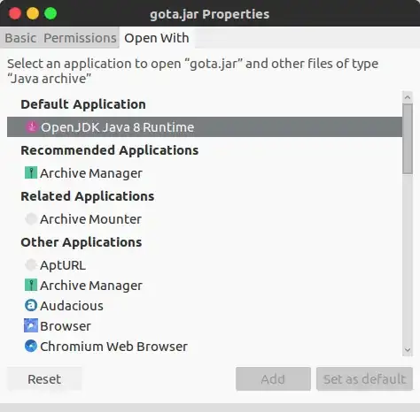

PROBLEM: I have a jar file in my downloads directory. Although I can go to terminal and use "java -jar" and it works, I want to be able to double click and execute the jar file.
  • Right click on .jar file
  • Select "Properties" tab
  • Select your Java Runtime
  • Press Set as default
Now you can open/execute any .jar file by double clicking them
UPDATE
If you cannot find "OpenJDK" option, maybe you don’t have the runtime environment installed. Use below command to install it.
sudo apt-get install openjdk-8-jre
