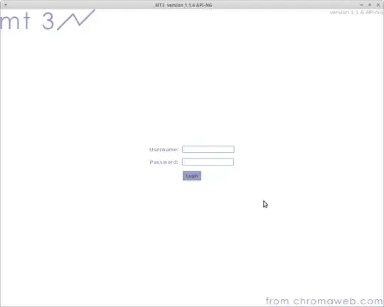

The following instructions were tested in Xubuntu 14.04 running in VirtualBox, because I don't like installing a betting program in a host OS, and even though mt3 does not run as root neither should you.
  1. Make a new folder on your desktop called mt3.
  2. Download the .zip (mt3.zip) from www.chromaweb.com to the mt3 folder.
  3. Unzip it.
  4. Open the terminal and navigate using cd to the mt3 folder you've unzipped it to. There should be a file in it called mt3.jar.
  5. Run the mt3.jar file with this command:
    java -jar mt3.jar
  6. An mt3 login window will open.
