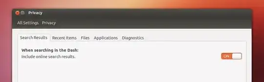

Click on the Ubuntu button, search for "Privacy" and then turn off "Include online results" :

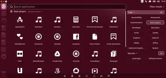

Click on "Filter" on the upper right of the dash, and then on "Type" right below. Then click on Dash Plugins to display them.
By clicking on the plugins of interest on the left you can get a summary of each plugin, including the Amazon one. You can disable or enable them individually with the button that appears below the summary.

To disable a dash plug-in, From the dash select filter results then "Dash plugins"
To disable a plugin, click on it and then click the "Disable" button. You can re-enable it later if you want.

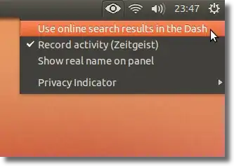

With Privacy Indicator you can quickly enable or disable online results:
Screenshot of Privacy Indicator
