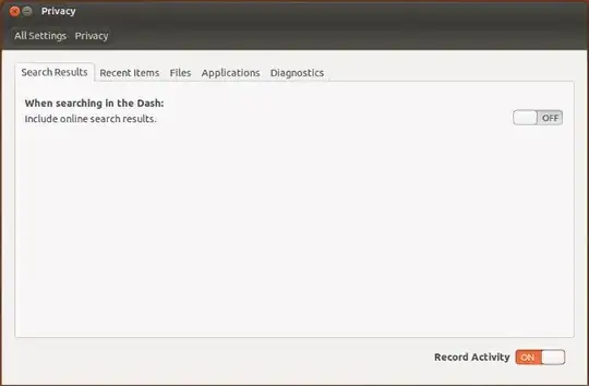

If you want Dash to only search your local computer and not search the Internet at all, you can open the Privacy app and switch "Include online search results" from on to off, as pictured below.

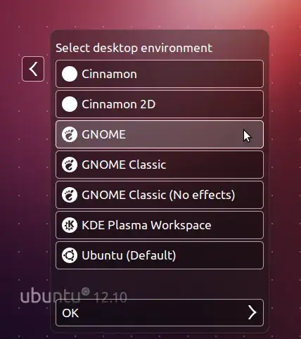

Finally, if you don't like the direction that Unity is going but you still like the Ubuntu operating system, you can switch to a different desktop environment altogether such as GNOME 3, KDE, or Cinnamon.
You can get GNOME 3 by installing the package called gnome-shell. You can get KDE by installing the package called kde-full. And you can get Cinnamon by adding the Cinnamon PPA to your repositories and then installing the package called cinnamon. Once you have installed a new desktop environment, you can choose which one you want to use from your login screen. Click the Ubuntu logo next to your username to change your desktop environment.
