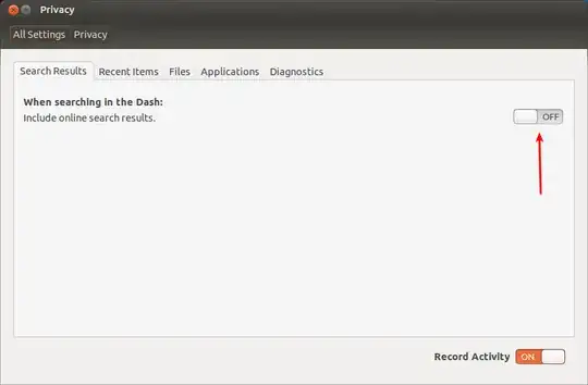

Also to disable this feature, you can search on dash for "Privacy":
Hope this helps.
