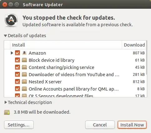

I wanted to remove "Amazon" from my 14.04 and tried to follow the instructions given here:
However, even after logging off and loggin back in, I see that I get the updates to "Amazon":
amazon updates
"Online search results" have been disabled in Security and Privacy settings. I even tried to remove it from the software center by using the button provided in the above question which says there is no package named unity-lens-shopping. And if I again try to remove unity-lens-shopping from the terminal using sudo apt-get remove unity-lens-shopping, unity-lens-home is selected and nothing is actually removed and I get the following output:
