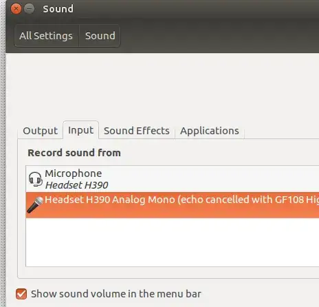

  3. Reload PulseAudio (pulseaudio -k) or simply restart the computer. You should be able to select the new Noise Cancellation option from the Input Device Section:
    screenshot

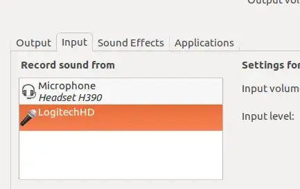

load-module module-echo-cancel source_name=logitechsource source_properties=device.description=LogitechHD
And again, restarting pulseaudio. The end result looks like this:
screenshot

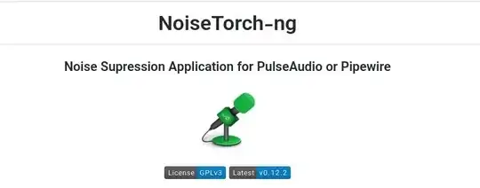

I use NoiseTorch in Arch Linux , is easy to use and easy to install => NoiseTorch Github Link enter image description here
