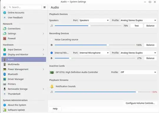

I have figure out my Solution! Below is the end results:
end results
I HAVE NOT TESTED IT YET!!!!

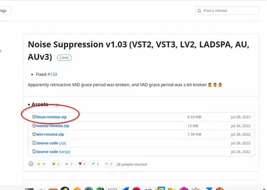

Download the latest version for Real-time Noise Suppression Plugin in your Downloads folder:
Here is the link > Noise Suppression v1.03 (VST2, VST3, LV2, LADSPA, AU, AUv3
Noise
Extract linux-rnnoise.zip file in your Download folder
