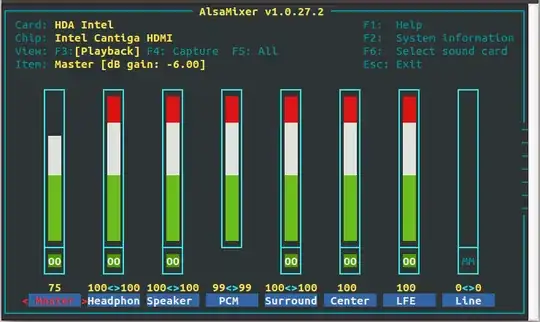

Make sure your microphone is connected to your computer and well configured. Run this command: alsamixer to check your microphone level.

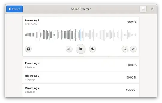

The Gnome Sound Recorder worked out of the box for me:
https://wiki.gnome.org/Apps/SoundRecorder
