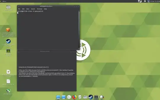

Then I opened pavucontrol and saw this :-
Screenshot of pavucontrol
Does anyone have a clue as to what I am doing wrong?
