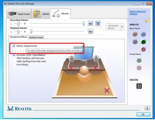

My soundcard is Realtek ALC 892. On Windows 7 I use official Realtek drivers, on Linux I use PulseAudio (on Ubuntu 13.10). On both Windows and Linux, when I enable microphone boost +30db (required because my microphone is quiet), I get very annoying and loud background noise (I also confirmed the background noise with Audacity on both systems).
However, Windows Realtek drivers have noise suppression option which works (after enabling it, Audacity shows no background noise and my ears also confirm that there is no background noise).
Image showing noise suppression option
My question is how can I enable background noise suppression in ALSA/PulseAudio? Is there any module I can install or maybe there is a setting for it that can be enabled in config file?
