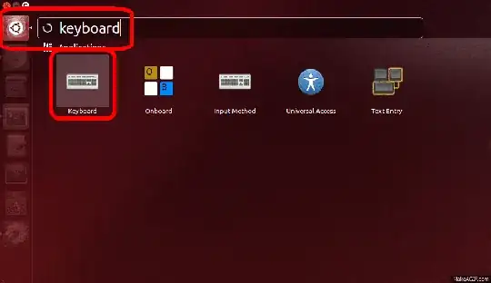

  1. Go to System Settings → Keyboard → Shortcuts → Custom Shortcuts.
  2. Click + to add a new keyboard shortcut. Set the "Name" to Volume up, "Command" to
    amixer -D pulse sset Master 5%+ and click Apply.
  3. Click Disabled next to your new key and choose the desired binding on your keyboard.
  4. Add another shortcut with name Volume down and command
    amixer -D pulse sset Master 5%-
Steps GIF
