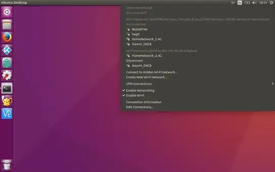

at can see upper wifi network disabled(on board ) and lower, connected ( via USB adapter )screencapture
Problem solved: After applying @pa4080 answer- device not managed screenshot
