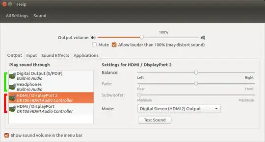

I'm trying to switch between the audio outputs of my video card from the command line. I'm able to do that via the GUI settings, as it's shown on the picture. How can I do this programmatically?
On the picture are presented two audio devices wit two outputs each:
  • (green) Device 1 - Built-in Audio with two outputs:
    • Digital Output
    • Headphones
  • (red)      Device 2 - HDMI Audio Controller of NVidia GTX 660. To the video card are connected two monitors:
    • The first monitor is LG TV and it is connected to HDMI-0.
    • The second monitor is LG ULTRAWIDE and it is connected to DVI-I-1.
So I want to switch, via the command-line, between the red outputs (the two monitors). Everything I've found, in my research, is how to switch between the audio devices (sound cards). I've already read few topics as these questions:

You can see (in this particular case) I'm searching for a way to switch between sink 16 and sink 17. But when sink 16 is presented in pactl list sinks, sink 17 is not presented and vice versa. I can switch them only from the GUI settings. Is ithere a way to do that via the command-line?

Thanks to the discussion with @Thomas I realised the proper therms (key words) are profile and card. In the terms of the question profiles are the inputs and outputs. The cards are the audio devices. And the sink numbers are not so important, but we need them.
