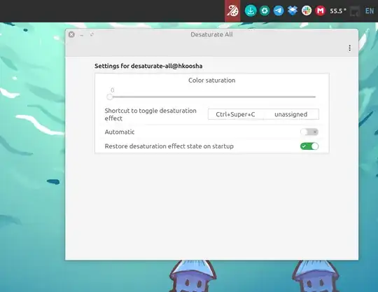

Cinnamon Desktop
Open applets, and install the Desaturate All applet. You can set a time when the applet automatically turns on (like bedtime mode in phones).
You can also set a custom keyboard shortcut (e.g. ctrl + super + c) to toggle the effect.

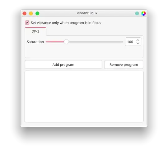

XFCE/MATE/other X11 based environments
This method works on supported Intel/NVidia/Radeon graphics, but does not work with non-standard systems, e.g. ARM Chromebooks.
Install vibrantLinux with flatpak (if you want to avoid flatpak, use the GitHub link below for other options).
sudo apt install flatpak
flatpak remote-add --if-not-exists flathub https://dl.flathub.org/repo/flathub.flatpakrepo
flatpak install io.github.libvibrant.vibrantLinux
Run the program, and set the saturation to zero.
For details, see https://github.com/libvibrant/vibrantLinux

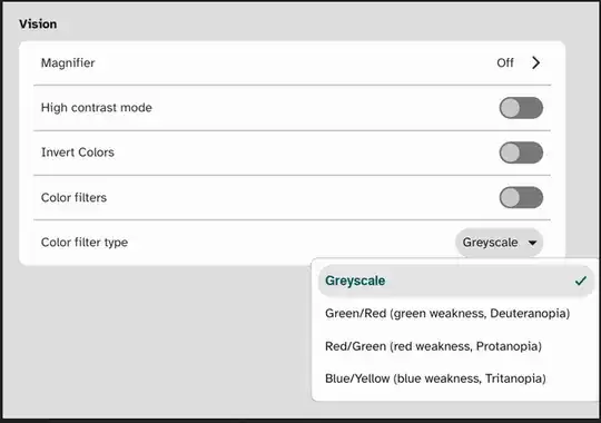

Cosmic desktop
You can set the system to be grayscale via the accessibility settings. enter image description here
Image source: https://github.com/pop-os/cosmic-epoch/issues/1751#issuecomment-2762378024
