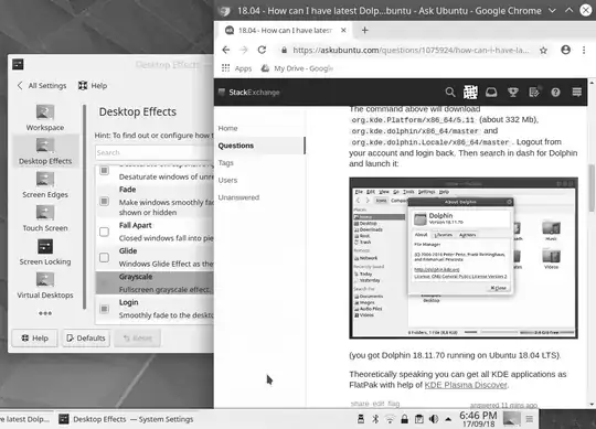

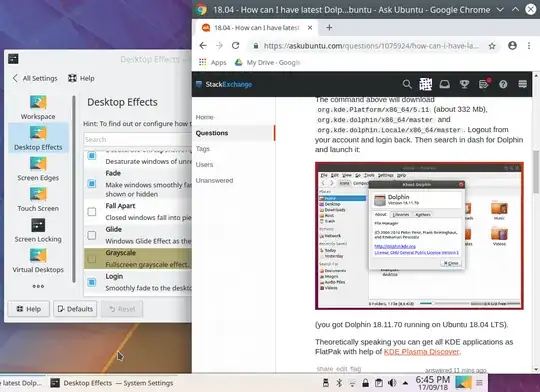

To test it for the first time, open System Settings > Desktop Behavior. In there, open Desktop Effects. You should see Grayscale in the Appearance section. Toggle it a couple of times, and you'll see the grayscale effect at work.
Grayscale off:
Grayscale off
Grayscale on:

Further configuration is possible. From the gitlab link:
A configuration file should be placed in /usr/share/kwin/effects/kwin4_effect_grayscale/contents/config/main.xml.
And available parameters are:
  • ApplyInactiveWindowsOnly (boolean) : Effect applies to inactive windows only if it's set true.
  • ExcludePanels (boolean) : Effect does not apply to panels if it's set true.
  • EffectStrength (integer): Effect strength by percentage (%).
