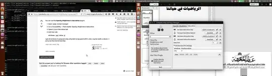

You can use the Opacity, Brightness & Saturation plug-in.
  1. Open ccsm Compiz manager
  2. Go to Accessibility → Then enable: Opacity, Brightness & Saturation
  3. Open it, Go to Saturation tab
  4. Add new rule:
    Windows: any Value: 0
I got all windows in grayscale only unity dash & top panel still in color, may be needs a reboot. :) sorry not the time to test that.
