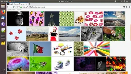

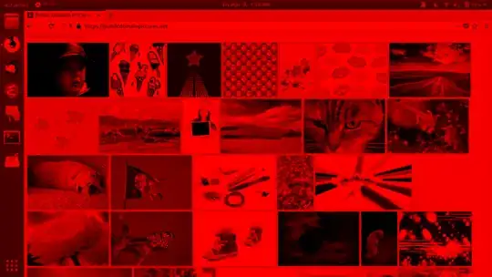

I think you will agree that a grayscale screen with Night Light works better than better Night Light by itself (if you use a color tempeture that is super low). Some things to look for: the scroll bar, the picture of colored penciles, Firefox logo, and the plant in the bottom left.
Here are some comparison screenshots:
Full Color Full Color
Grayscale Grayscale
Night Light/Redshift with Full Color Night Light with Full Color
Night Light/Redshift with Grayscale Night Light/Redshift with Grayscale
