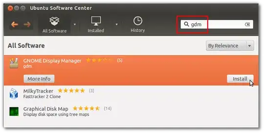

Easily switch to GDM with the Software Centre
  1. Open the Software Center, type "gdm" in the search box, and click on Install as shown below, or click on this button: gdm Install gdm

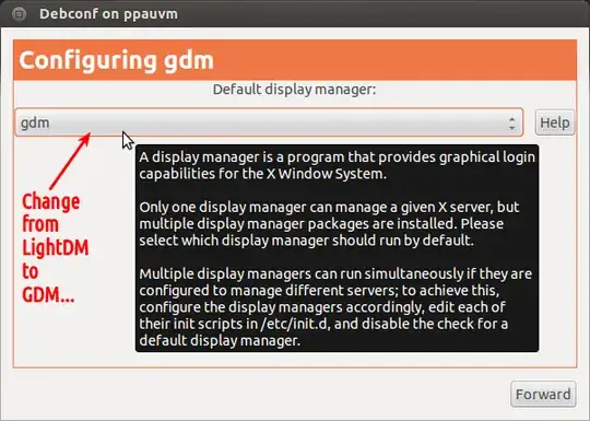

  2. After you enter your password, you will get the configuration screen shown below. Change lightdm to gdm and click on Forward:

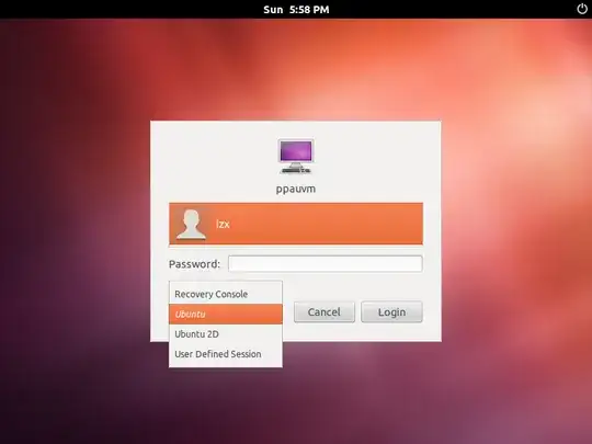

  3. Restart your computer, and you should now have the "old" GDM login screen; note that you can still select from any available session, including Ubuntu (3D), Ubuntu 2D, Gnome, Gnome Classic, etc.

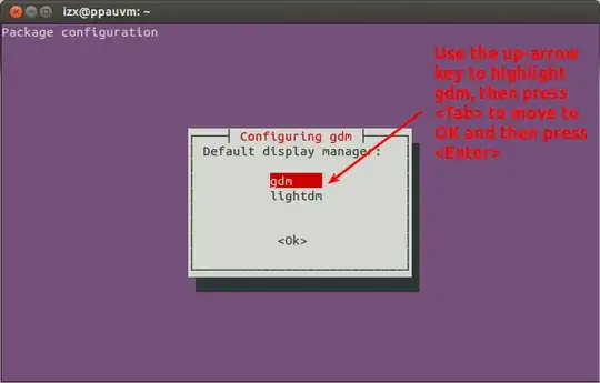

Switch to GDM via the terminal
  1. Open a terminal with Ctrl+Alt+T if you are on the desktop and not in the recovery console.
  2. Type sudo apt-get install gdm, and then your password when prompted or run sudo dpkg-reconfigure gdm then sudo service lightdm stop, in case gdm is already installed.
  3. A "Package Configuration" dialog will be displayed; click OK to proceed to the below screen. Use the arrow-keys to select gdm instead of lightdm, press Tab to move to OK, and press Enter.
  4. Reboot the computer (you can do this with sudo reboot if in the recovery console).
