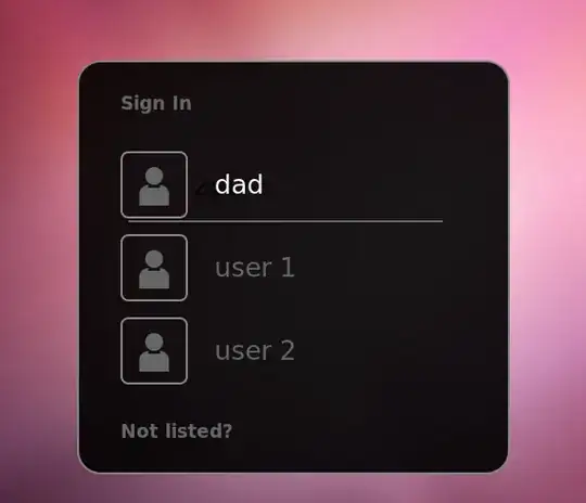

Tista and three other dev's have done just this (see link below).
Tista has created a testing PPA to install GDM 3.2 - this is the version of the login manager which you can theme via CSS.
Warning - this is a testing PPA
At the time of writing this, there are only packages for Precise (12.04)
I originally tested this on a 11.10 virtual machine when a package existed - hence the screenshot:

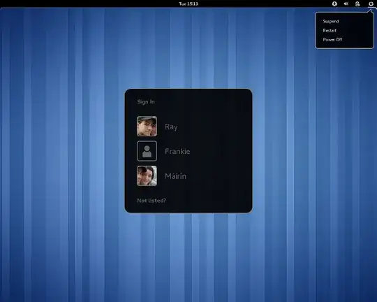

changing the background
To change the background, use the AU linked question below to change the background.
The Gnome-shell stripes background can be found on GitHub.
