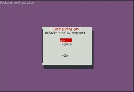

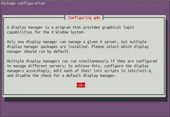

During the install, you should see some screens like below:
GDM_1
Press Enter for OK and on the next screen, select the Display Manager you want:
GDM_2
Press Enter to select the Display Manager.
