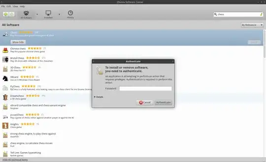

This only applies, to using the sudo command in the terminal. You'll still be prompted for your password if you (for example) try to install a package from the software center
gui password prompt
