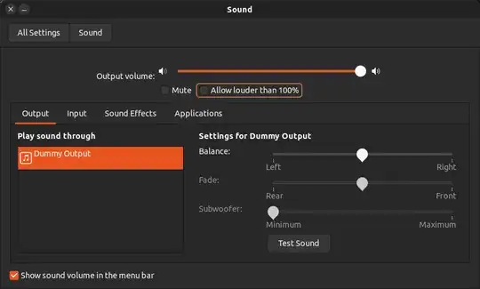

So, I just installed Ubuntu Unity 22.10. The installation was fine, but booting into the system, there was no sound. In the sound settings, I could only find an output called "Dummy Sound".
screeshot of Sound settings

I had the same issue, but this solution helped me: No sound output devices listed after upgrade from 21.10 to 22.04
sudo touch /usr/share/pipewire/media-session.d/with-pulseaudio
systemctl --user restart pipewire-session-manager
I reinstalled my system many times in order to see what solution did it right.
Finally I had to follow all those steps:
  1. ln -s /usr/share/pipewire /etc/pipewire
  2. sudo touch /usr/share/pipewire/media-session.d/with-pulseaudio
  3. systemctl --user restart pipewire-session-manager
  4. systemctl --user start pulseaudio
  5. reboot
If one of those steps wasn't done, the audio didn't came up.
I did found information about intel audio drivers/settings, but it didn't make a difference. So I did not need it on my last installation.
This after a clean install of Ubuntu server 22.10 (5.19.0-23-generic) with Cinnamon 5.4.12 as only desktop environment using muffin and slick-greeter.
Special thanks to all of you for the provided information !
I made a bash menu to do this quickly when I need to reinstall my system. It can be found here.
Solution for my case - after upgrading from 22.04 to 22.10:
Install libraries:
sudo apt install libldacbt-{abr,enc}2
sudo apt install libspa-0.2-bluetooth pipewire-audio-client-libraries pipewire-media-session
sudo cp /usr/share/doc/pipewire/examples/alsa.conf.d/99-pipewire-default.conf /etc/alsa/conf.d/
After reboot, it starts working.
What fixed this for me was to copy the pipewire folder from /usr/share to /etc. I then rebooted, and it all just worked.
I also had no sound after the upgrade. My machine has a Threadripper 3960x which uses an ALC1220 USB solution for audio. After the upgrade I only had the dummy devices for my speakers and my input.
What worked in the end for me is the following:
  • sudo apt install libldacbt-{abr,enc}2
  • sudo apt install wireplumber
  • systemctl --user --now enable wireplumber.service
Immediately after the last command the devices appeared in gnome settings, and sound worked. Only problem left is that I always have to switch output from dummy to Speakers - USB after every boot.
