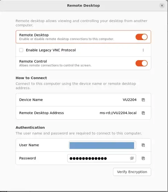

Update for Ubuntu 22.04 and above
Ubuntu 22.04 and above now allows RDP (and legacy VNC) protocol for remote desktop sharing and control when the user is logged in. This method uses the app Gnome Remote Desktop in the remote computer and is configured through the System Settings app.
The screenshot above shows the RDP preotocol setup.
Notes
  1. You must be locally logged in, in the remote computer (attached to TV). If you are logged out, this will not work.
  2. When using Remmina or Windows RDP in your laptop to connect to the desktop you will need to use the username and password set up in the Settings page above.
  3. See Connect when Remote Desktop is on login screen or screen locked (without autologin) for how to add the gnome extension Allow Locked Remote Desktop so that the remote computer can be accessed even with the screen is locked.

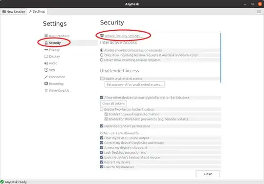

Unattended Access
By default AnyDesk does not allow unattended access. That is, when someone tries to remotely access your main computer using AnyDesk you will have to accept the connection from within the main computer. This is not possible in your use-case.
Open AnyDesk on your main computer. Click on the "hamburger" menu icon on the top left corner and click on Settings
Go to the Security tab on the right panel of the Settings window.
You have to click on the Unlock Security Settings and enter your password to get this page to work. Once unlocked you will see a page like this:
Check the Enable Unattended Access box and set a password. If you want you can also enable Two Factor Authentication. This will require installing an app on your phone that can generate two factor authentication tokens, such as Google Authenticator, or Authy.

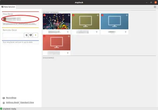

Finally, note down the AnyDesk ID number of your main computer. You can see it under the This Desk heading on the left panel.
You can close the Anydesk app on the Main computer. The app need not be open for remote access.
On your laptop open AnyDesk and enter the ID number of the main computer in the Remote Desk box on the left panel and click on the Play icon ▶.
