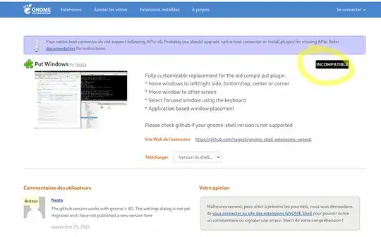

I wrote this popular answer for Ubuntu 18.04 and 20.04, but now it won't work on Ubuntu 22.04 due to Wayland.
https://github.com/negesti/gnome-shell-extensions-negesti#wayland--wnck:
Because of this dependency and the different concepts of wayland and X11 to identify applications (wm_class vs. application_id) Wayland is not supported!
And from https://extensions.gnome.org/extension/39/put-windows/:
Any ideas, fixes, or alternatives?
This is something but isn't very useful, in my 2 minutes of playing with it: https://help.ubuntu.com/stable/ubuntu-help/shell-windows-states.html.en
In case this matters, a fresh Ubuntu 22.04 install has GNOME Shell 42.5, as shown by gnome-shell --version.

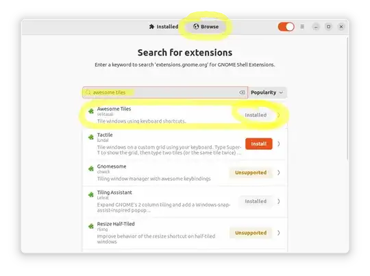

Open its GUI by pressing the Windows key and typing "Extension Manager". Its icon is a blue puzzle piece:
Click the "Browse" tab at the top, then search for "awesome tiles". Click the "Install" button to install it. Here you can see mine is already "Installed":

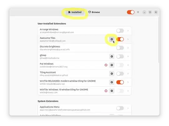

Click the "Installed" tab at the top, ensure the slider shows "Awesome Tiles" as activated (click the slider to activate/deactivate it), then click the gear icon to modify its settings:

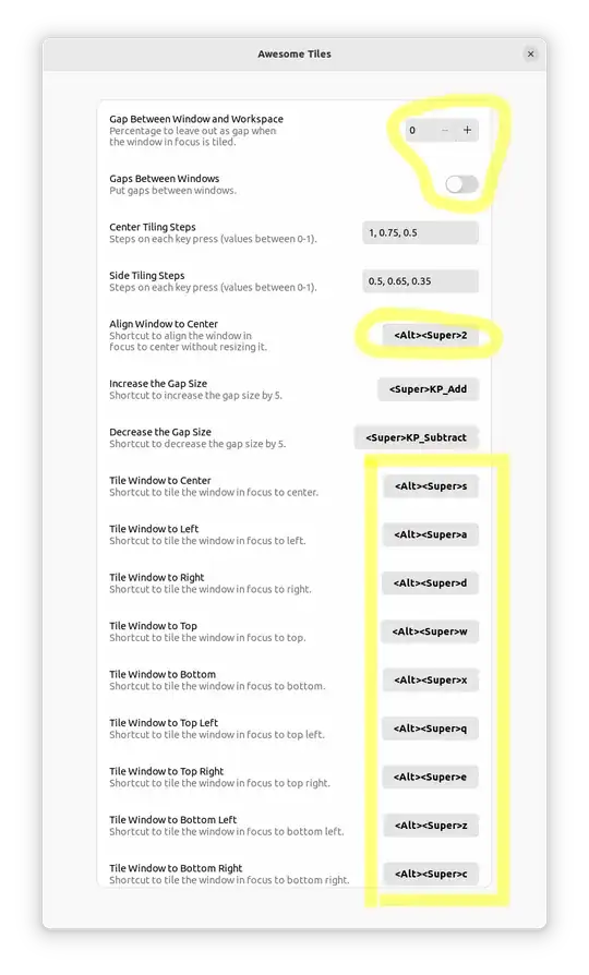

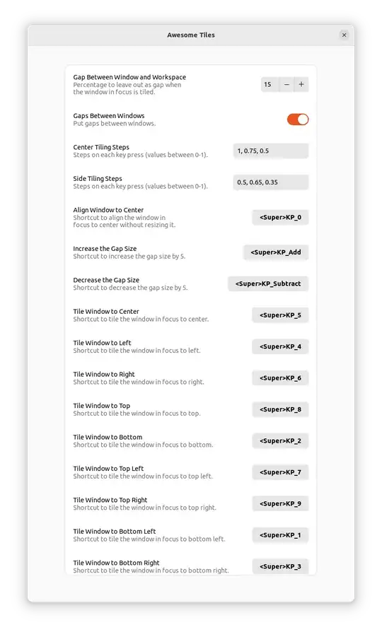

Here are the default settings and shortcut keys it uses:
As you can see, it uses the Super (Windows) key + the keypad keys. A lot of smaller laptops and keyboards, however, do not have the keypad on the right side of the keyboard, so I recommend you use the Alt + Windows + Letters shortcuts which I've used in "Put Windows" before. Also, I really hate the gaps all around the windows (like a lot--so much so that I woulnd't recommend this tool at all if I couldn't remove them), so I recommend you remove the gaps by changing "Gap Between Window and Workspace" to 0, and disabling "Gaps Between Windows".
But, before we can add all of the shortcuts I like, we have to disable the default Ubuntu Alt + Windows + S "screen reader on or off" shortcut, which interferes. Go to your Ubuntu Settings --> Keyboard --> click "View and Customize Shortcuts" --> type in "alt+super+s", as shown here:
Click the "Turn screen reader on or off" shortcut you can see which is currently assigned to Alt+Super+S, and press Backspace to disable the shortcut --> click the "Set" button. You can now see it is "Disabled". Perfect:
Now go ahead and change your "Awesome Tiles" keyboard shortcuts to be as follows. Remember that the Super key is the Windows key on a PC. Here are my new settings. I have highlighted all of the ones I just changed:

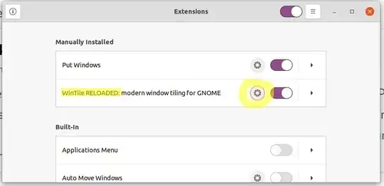

Enable and configure it

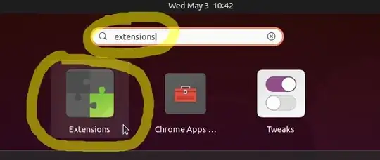

After logging out of Ubuntu and logging back in, press your Windows key and search for "Extension Manager". As of Ubuntu 22.04, it's a blue puzzle piece, as previously shown above. Click it. Click the slider to activate "WinTile RELOADED". Click the gear icon and set your settings like this:
That's it! Drag windows to the corners or edges of your monitor to your heart's content.

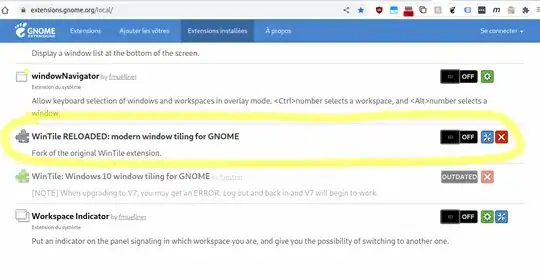

Note that there are two ways to change the settings:
  1. Option 1: via the browser:
    1. Go here: https://extensions.gnome.org/local/.
    2. Under the "Installed Extensions" heading, look for "WinTile RELOADED".
    3. Click the little tool (blue screwdriver and wrench) icon.
  2. Option 2 [my preference]: via the gnome-shell-extension-manager GUI that you should have installed as part of the "Extension 1" instructions above.
    1. Press your Super (Windows) key, and type in "extensions". Open the "Extensions" tool.

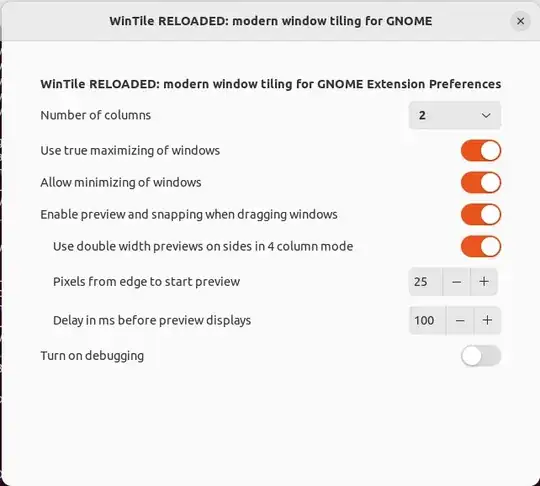

    2. Find "WinTile RELOADED" and click the round settings button.
In both cases, the above settings window is opened. Here are the possible settings to tweak. I decreased my Delay in ms before preview displays setting from the default 500 ms to 100 ms to make it much snappier, and I decreased my Number of columns setting from 3 to 2.

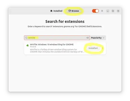

Install WinTile from the Gnome Extension Manager
Press your Windows key and search for "Extension Manager". As of Ubuntu 22.04, it's a blue puzzle piece, as previously shown above. Click it. Click the "Browse" tab at the top, then search for "wintile". Click the "Install" button to install it. Here you can see mine is already "Installed":

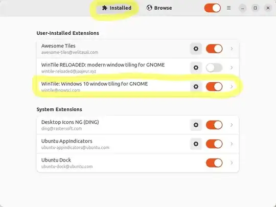

Click the "Installed" tab at the top, ensure the slider shows "WinTile" as activated (click the slider to activate/deactivate it). If you have previously installed WinTile Reloaded and it is still active, disable it by clicking its slider to turn it off. Here's what I see:
Click the gear icon next to it now to configure settings.

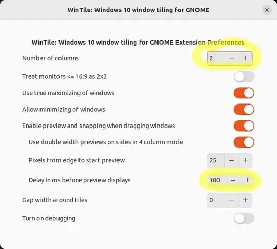

WinTile Configuration options
There are two ways to change the settings:
    2. Under the "Installed Extensions" heading, look for "WinTile RELOADED" "WinTile": enter image description here
    3. Click the little tool (blue screwdriver and wrench) icon: enter image description here
    1. Press your Super (Windows) key, and type in "extensions". Open the "Extensions" tool: enter image description here
    2. Find "WinTile RELOADED" and click the round settings button, circled here: enter image description here
In both cases, the below settings window is opened. Here are the possible settings to tweak. I decreased my "Delay in ms before preview displays" setting from the default 500ms to 100ms to make it much snappier, and I decreased my "Number of columns" setting from 3 to 2.
