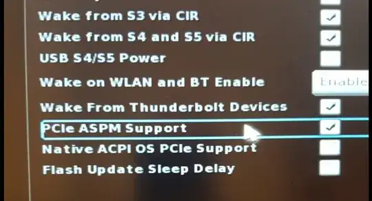

Here is what fixed this issue for me on Kubuntu 20.04 Intel NUC PC (NUC8i7HVK), which has Intel HD graphics + embedded Radeon RX Vega M GH:
I went into UEFI BIOS settings and enabled PCIe ASPM (Active State Power Management). I left some other settings such as "Native ACPI OS PCIe" disabled
Enable ASPM in UEFI BIOS
This is very easy to test so give it a shot and see if it helps.
