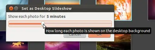

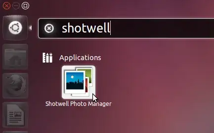

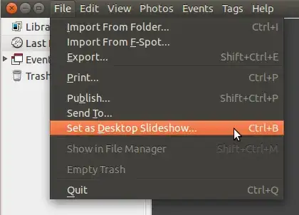

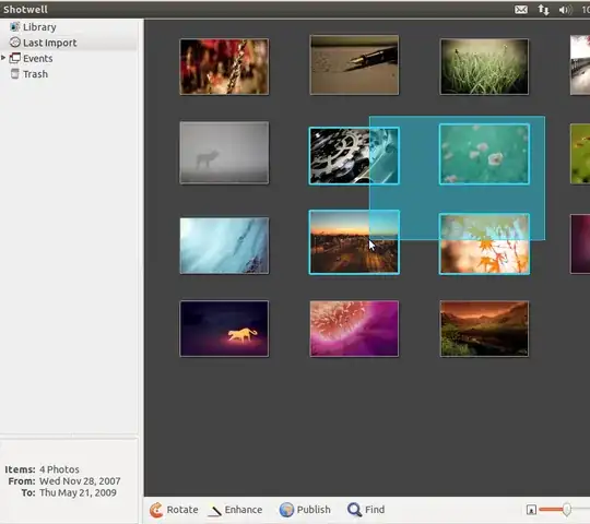

If you use it to manage your photos and like it easy I recommend to use Shotwell, which should be installed by default.
Open it:
open shotwell
Select the photos you want to be set as background slideshow:
select images
Open FileSet as Desktop Slideshow or press Ctrl+B:
set as slideshow
Adjust time settings:
set time
Done.

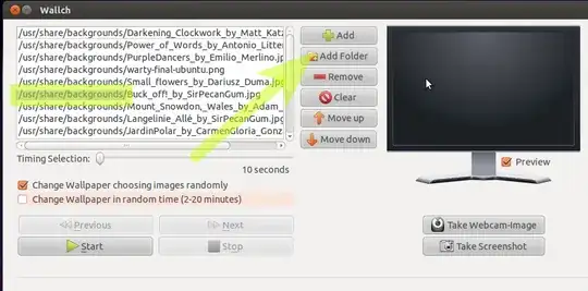

Wallch
In software center there are two wallpaper changer - wallch for Gnome-Shell/Unity/Gnome-Classic and Wally for KUbuntu.
Lets concentrate on Wallch.
Sadly the version of Wallch in the software centre is outdated and has many issues especially with 14.04! There's a repository with the recent version.
To install, add the repository (you don't need to do this on 16.04):
sudo add-apt-repository ppa:wallch/wallch-daily
Then install Wallch:
sudo apt-get update && sudo apt-get install wallch
Then start from Dash:

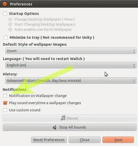

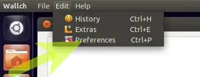

Lets now launch the application preferences:
Let's untick the bubble notification - its annoying - at the same time you could disable sounds!
At the same time you can define the start-up options:

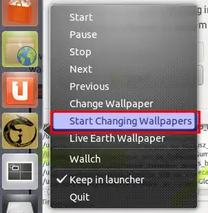

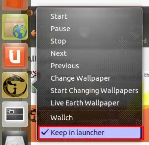

Save - and add a folder of pictures - in this example, use /usr/share/backgrounds for the default wallpapers that come with Ubuntu
Now we've got two choices:
Start up choice 1
(thanks @Naruto)
keep wallch in in the launcher
exit wallch and start changing wallpapers
Start up choice 2

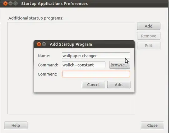

start wallch on login without needing to have a launcher
From the dash:
Then create a new startup application with the command wallch --constant
N.B. - for some computers this will not work. The solution is to introduce a delay to the startup of the wallch daemon as per the following Q&A:
Wallch not auto-cycling backgrounds on log in

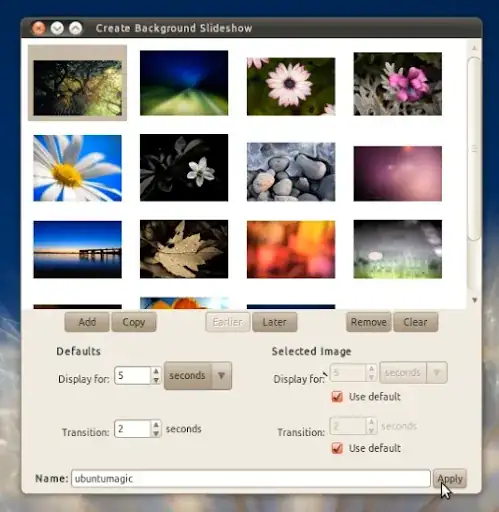

For 11.04 and previous versions
There's a program for creating wallpaper slideshows called CREBS. Check out this article about it: http://www.omgubuntu.co.uk/2010/05/crebs-the-ultimate-wallpaper-slideshow-application
A simpler app that has fewer features but is easier to use can be found here: http://gnome-look.org/content/show.php/Wallpaper+Slideshow?content=125178

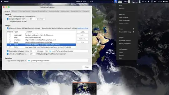

IMG:   Variety
Homepage: http://peterlevi.com/variety
Github: https://github.com/varietywalls/variety
Variety is a wallpaper manager for Linux systems. It supports numerous desktops and wallpaper sources, including local files and online services: Flickr, Wallhaven, Unsplash, and more.
Where supported, Variety sits as a tray icon to allow easy pausing and resuming. Otherwise, its desktop entry menu provides a similar set of options.
Variety also includes a range of image effects, such as oil painting and blur, as well as options to layer quotes and a clock onto the background.
Install
It's available in the Universe repo. To install it, run
sudo apt install variety
Also you can install it from Peter Levi's PPA by running
sudo add-apt-repository ppa:peterlevi/ppa
sudo apt-get update
sudo apt-get install variety

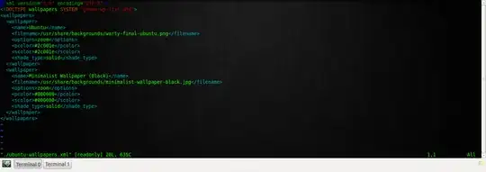

For gnome 3, generate the xml using one of the previous answers, then you could add the generated xml via the command line:
gsettings set org.gnome.desktop.background picture-uri 'file:///home/pykler/.backgrounds/realtime/background.xml'
Another Solution (this will add your bg to the Appearance area under gnome-control-center):
mkdir -p ~/.local/share/gnome-background-properties/
cat >~/.local/share/gnome-background-properties/custom-wallpapers.xml <<EOF
<?xml version="1.0" encoding="UTF-8"?>
<!DOCTYPE wallpapers SYSTEM "gnome-wp-list.dtd">
<wallpapers>
  <wallpaper deleted="false">
    <name>Pykler</name>
    <filename>/home/pykler/.backgrounds/realtime/background.xml</filename>
    <options>zoom</options>
  </wallpaper>
 </wallpapers>
EOF
Replace the name "Pykler" and the path "/home/pykler/.backgrounds/realtime/background.xml" as needed.

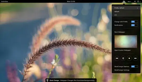

IMG:   Desk Changer for GNOME shell
by egach
In case you use gnome-shell (version > 3.8, default in Ubuntu 17.10 and later), use this nice extension.
Simple wallpaper changer with multiple profile support. Supports integration into the system menu or its own panel icon. The daemon is written in Python and runs independently of the extension.
Extension Homepage: https://github.com/BigE/desk-changer/
Install
First you have to install gnome-tweaks
sudo apt install gnome-tweaks
Visit the gnome-extension homepage and switch the slide on. Afterwards you can configure the extension to change the background's change time and the backgrounds itselfs. To do so open gnome-tweaks, go to the Extension tab and click on the Configure icon of the desk-changer.

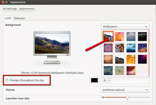

Yes, you can.
Locate an already made animated wallpaper and modify it.
For example, there should be one in /usr/share/backgrounds/contest (at least on Precise Pangolin).
The file is called precise.xml in my case and it is an XML file. All you need to know to modify it is that any tag like <background> contains other tags and texts and must be closed with </background>.
Try to find out what these tags mean (see below), change the name of these pictures and save as... somewhere. Call it whatever_you_want.xml.
Then change your background: choose a new wallpaper by browsing your computer and, instead of choosing a .jpg, choose your .xml.
Some tags:
<background> contains everything. Your file must begin with it and end with </background>. It's called the root tag.
<starttime> defines when the diaporama starts. A precise date must be given, any date.
<static> contains the definition of a still image.
<transition> is used to fade from one image to the other.

I wanted the changing wallpaper and custom wallpaper pictures to appear under the default options for selecting a wallpaper in Ubuntu 12.04,so I did the following
Using Terminal navigate to:
/usr/share/gnome-background-properties
typing ls will list all files in that folder you should see a file called precise-wallpapers.xml, back it up in case something goes wrong
sudo cp ./precise-wallpapers.xml ~
then edit it to add wallpapers that you want to appear in your default wallpaper options
sudo gedit precise-wallpapers.xml
this is how I added a polarbears wallpaper, previously I copied the precise.xml located in the contest folder and edited it with pictures that I wanted to display:
<wallpapers>
    <name>Ubuntu 12.04 Community Wallpapers</name>
    <filename>/usr/share/backgrounds/contest/precise.xml</filename>
  </wallpaper>
  <wallpaper>
    <name>polarbears</name>
    <filename>/usr/share/backgrounds/polarbears/polarbears.xml</filename>
  </wallpaper>
  <wallpaper>
    <name>Delicate Petals</name>
    <filename>/usr/share/backgrounds/Delicate_Petals_by_lefthandgergo.jpg</filename>
    <pcolor>#000000</pcolor>
    <scolor>#000000</scolor>
    <shade_type>solid</shade_type>
  </wallpaper>
  <wallpaper>
you can add regular jpg or png files, I recommend copying them to the /usr/share/backgrounds then adding them to this xml file. I hope this helps.

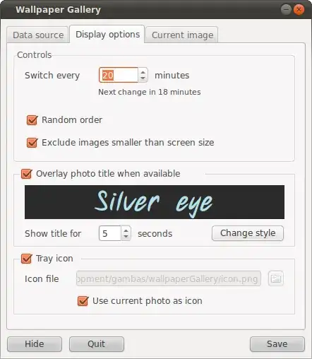

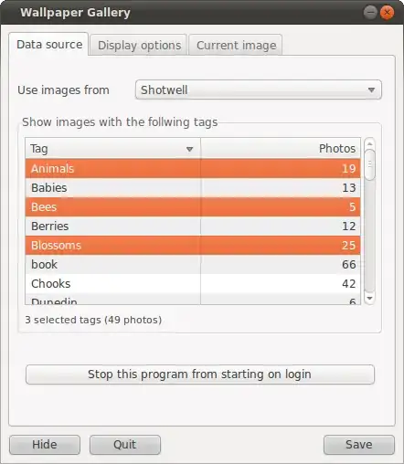

You might be interested in a program that automatically creates such a wallpaper-slideshow.
According to this OMG! Ubuntu post, you have for example 'Wallpaper Gallery'. It takes as input data tagged photos from your Shotwell gallery. Therefore it becomes very easy to add & remove photos for instance.
First select the tags concerning the photos you want to be displayed, then configure as you wish the switching time, the order, etc. Here some screenshots :
Wallpaper Gallery display options Wallpaper Gallery data source

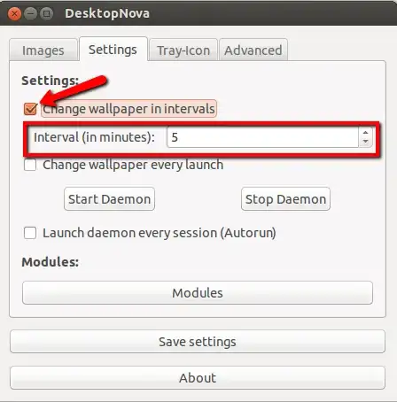

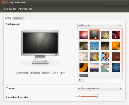

Change it from appearance, under system settings as seen below

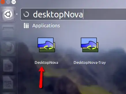

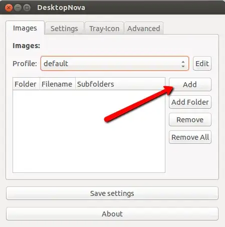

Or you can do so, by installing Desktop Nova. To install, just press Ctrl+Alt+T on your keyboard to open Terminal. When it opens, run the command(s) below:
sudo apt-get install desktopnova desktopnova-tray desktopnova-module-gnome
Once installed, search for it in Dash, and click on it, and when the program open, add your images, and setup the time interval.
Command complements of Desktopnova

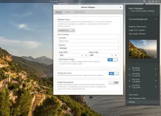

IMG:   Random Wallpaper for GNOME shell
by iFlow
In case you use gnome-shell (version > 3.12, default in Ubuntu 17.10 and later), use this nice extension. This extension fetches a random wallpaper from an online source and sets it as desktop background. The desktop background can be updated periodically or manually.
Online sources: - unsplash.com - desktopper.co - wallheaven.cc - reddit.com - basic JSON APIs or Files (See the GitHub wiki for more information) (Chromecast, Bing, NASA, Google Earth View, etc.)
Extension Homepage: https://github.com/ifl0w/RandomWallpaperGnome3
Install
Visit the gnome-extension homepage and switch the slide on. Afterwards you can configure the extension. To do so open gnome-tweaks, go to the Extension tab and click on the Configure icon of the random-wallpaper.

After seeing this request, I was curious about a solution and found something to be able to get your wallpaper image to be a part of the default wallpaper selection when going into System Settings >> Appearances. Follow the steps below in a terminal:
  1. cd /usr/share/gnome-background-properties
    • This will take you to the specific path mentioned
  2. sudo cp ./ubuntu-wallpapers.xml ~
    • This will copy the file ubuntu-wallpapers.xml into your home directory
  3. sudo vim ./ubuntu-wallpapers.xml
    • The command vim is a terminal editor but you can change it to gedit if you wish
Once you are in that file, you will see tags called <wallpaper> and </wallpaper> that is around the other tags like <name> and <options>. You will need to copy that and paste it right below that entry. Once done, you should edit that extra entry you added to match what you want. An example can be found below:
In this example, I made changes to the <name>, <filename>, <pcolor>, and <scolor> information to match what I needed for the wallpaper I wanted. Now I see the wallpaper as a default selection in the wallpaper section of the System Settings -> Appearance GUI:
If anything doesn't work, use the following command to import back the save file we made from above:
sudo cp ~/ubuntu-wallpapers.xml /usr/share/gnome-background-properties/
Hope this helps.

Go to System Settings > Appearance then mark the photo with clock on it at the right side.
