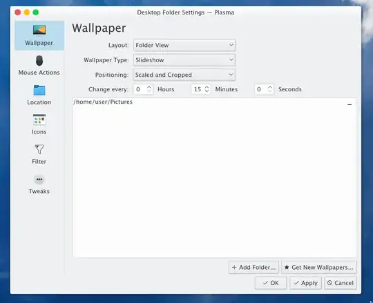

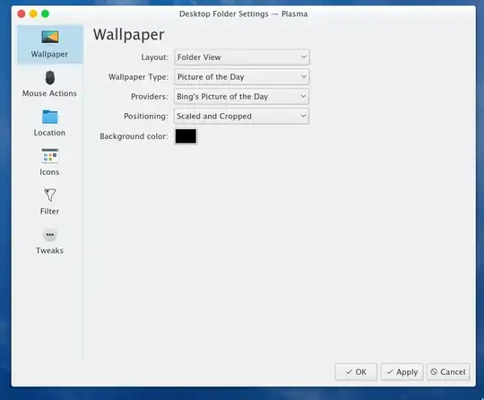

kurja
  • 681
Kubuntu can do this out of the box as can most any other KDE system. It also has a feature to pull images daily from Bing, Wikipedia and more.
Example of Desktop Folder Settings Example of Picture of the Day in KDE
