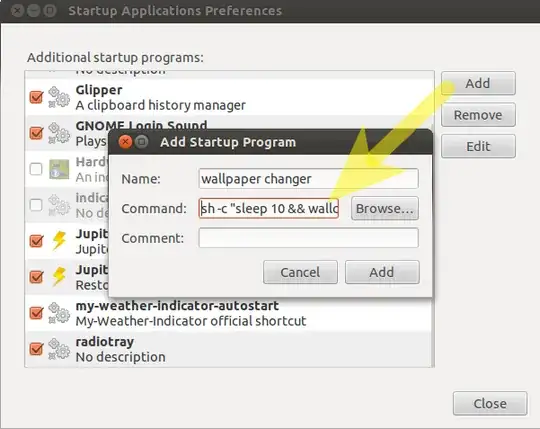

This could be a timing issue with the startup application with the command line
wallch --constant
I would suggest you introduce a short delay before starting wallch as a background process.
Search in Dash for startup application
Then add a new startup application:
Use a startup application command line of:
sh -c "sleep 10 && wallch --constant &"
