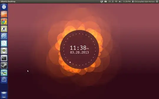

  • Circles
    LiveWallpaper screenshot - Circles

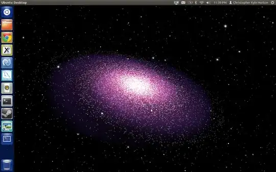

  • Galaxy
    LiveWallpaper screenshot - Galaxy

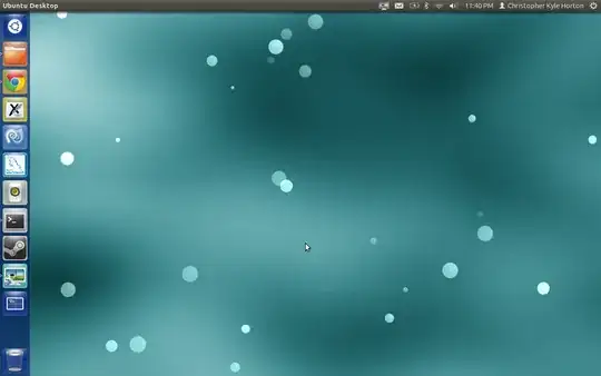

  • Noise
    LiveWallpaper screenshot - Noise

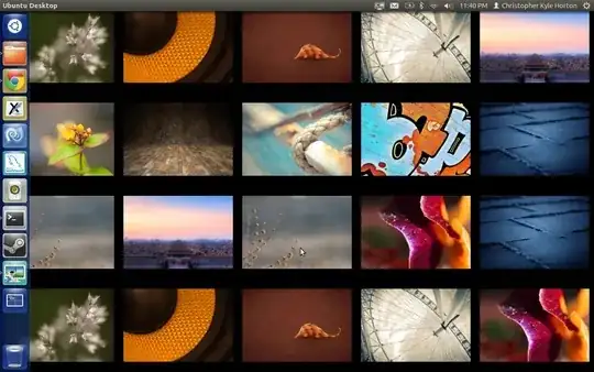

  • Photoslide
    LiveWallpaper screenshot - Photoslide

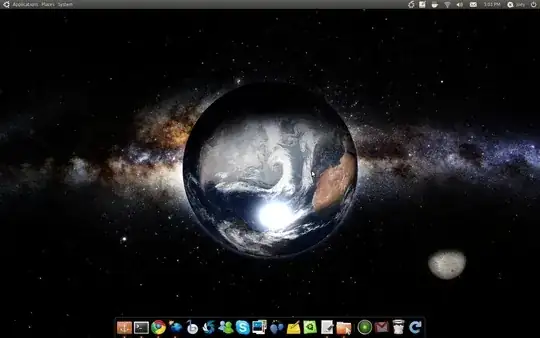

I have seen 2 backgrounds that are animated and there is a package called xplanet for one of them inside USC. This website is where it comes from.
It is a picture of the earth and moon turning and looks absolutely amazing.
Unfortunately I cannot get this to work in 11.04.

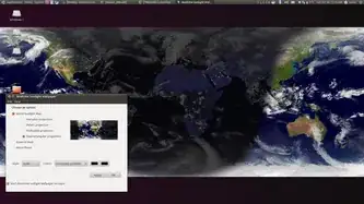

There is also one with real time sunlight. A PPA to install it can be found here
