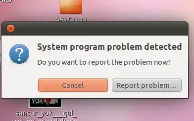

Hello,
I'm getting this error every time when I boot my computer. My Ubuntu installation is fresh and I was got a few error on last step while install Ubuntu (because i have problem with my CDROM driver). Anyway, installation is continued .
