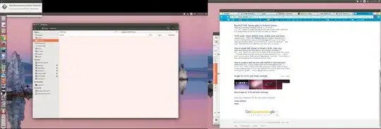

Take a screenshot of your entire desktop (using gnome-screenshot or the Print Screen key).
This is the image you just uploaded:
your screenshot
As you can see, there's a dialog window sitting in the top left desktop corner, so that most of it are outside your visible area.
You can move the window back into the visible area by holding the Alt key and then dragging the window using the mouse while holding the left mouse button. By holding the Alt key, it is irrelevant on which part of the window you click, you can grab it anywhere, not only at the title bar.
