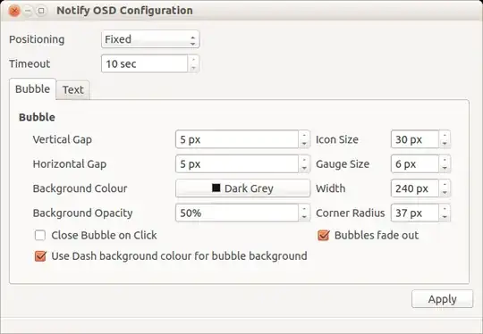

To use the congfiguration tool type "notify" into the dash and launch the NotifyOSD Configuration application.
Modifying the Notifications

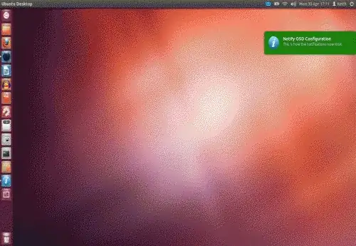

  • From this application you can change the colour of the notifications by clicking on the Background Colour box (in the picture below I've turned it a horrible green!).
  • To change the length of time the notifications appear on screen adjust the value in the Timeout box
The tool also includes other customisations including:
  • Change font, opacity, size, corner radius
  • Disable fade out
  • Close the notifications on click
  • Enable/disable "use Dash background colour for the notification bubbles"

  • In the Position drop down box you can choose from Fixed and Dynamic, dynamic gets rid of the gap between the notification bubble and the top dash

In my tool there are 3 Checkbox options at the end of Bubble tab which is not shown in previous answer's image, these options worked for me, I'll suggest U recheck the procedure of installation of this tool.
