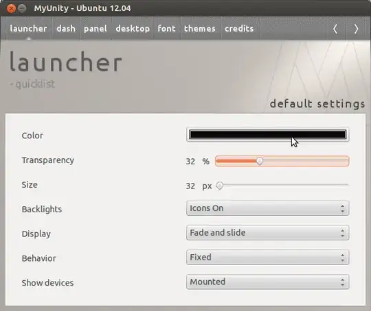

You can force the launcher to stay one colour and not change to imitate the wallpaper colour by installing the MyUnity tweaking tool from the Ubuntu Software Centre.
When installed navigate to the Launcher tab and click the color bar
Screenshot of MyUnity, clicking colour bar
Select your preferred colour from the colour wheel and the launcher will remain that colour no matter what the wallpaper colour is.

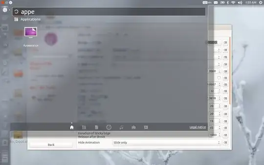

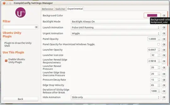

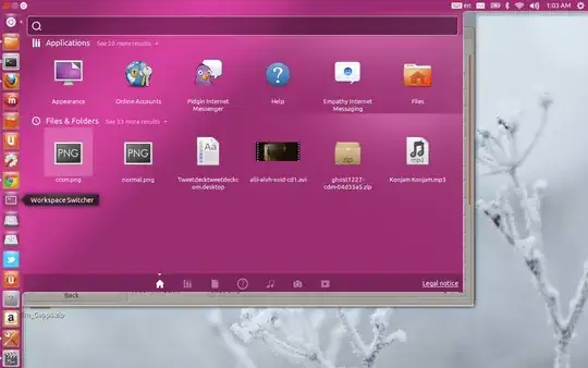

For 12.04 & 12.10
To stop the dash and launcher to use the same color of the wallpaper. You can use CompizConfig Settings Manager to override this behavior.
  • Open CompizConfig Settings Manager
  • Search for Ubuntu Unity Plugin and open it.
  • Click on Experimental tab
  • Now click Background Color option and enter your desired color for dash & launcher.
Normal Behavior
After applying the changes
