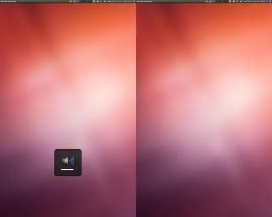

I'm using Unity on Ubuntu 12.04 and when I change the volume, I get a different volume indicator than the stock 12.04 notification. Based on what I've found searching through google, it is the gnome volume indicator. How can I change it back?
Things I have installed that I think may have affected it:
  • compizconfig settings manager
  • gnome-shell
Volume Notification

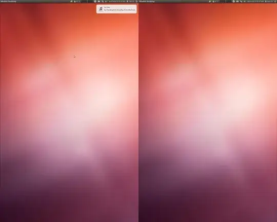

Additionally, the notifications have changed color. I tried the solution described here but it did not have any affect on the notifications whatsoever.
Regular Notification

I had installed xubuntu-desktop and the solution to both of these notification problems was to remove xfce4-notify: solution
